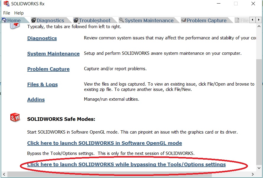

I'm running SWx 2016-17 on a new 8th gen i7, 8GB RAM, Intel HD 630 graphics laptop. The orange dynamic highlighting is SUPER slow when I drift over an edge. But when I open SWx in the safe mode shown below from the SOLIDWORKS Rx, the issue is fixed, so this is not an issue with the hardware of the computer.
I don't want to have to open SWx like this every time as it will be inconvenient. Any suggestions for a fix? I tried the registry editing from online, I updated the graphics driver to the most recent, and tried rolling back, nothing worked. any help is appreciated. Thanks.
