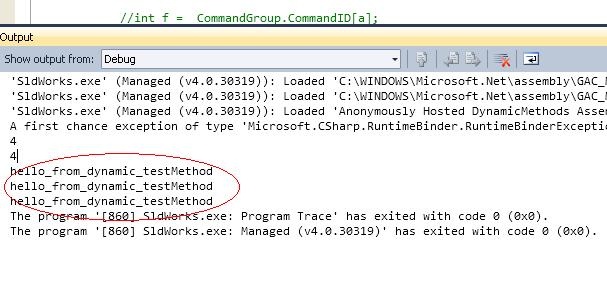

We run our addin, click our command button 3 times and we're all good:
