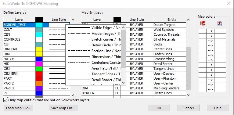

Hi all,
I am kind of new to setting up mapping files and trying to figure out a few things and wonder if there was a basic cheat sheet on what meant what in each program so to speak

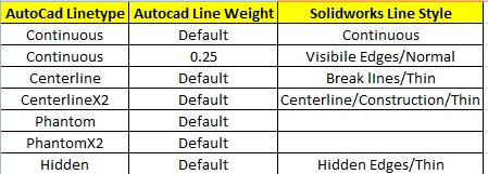

Like the line type styles as I can set things to go to Centerline and Centerlinex2 by either choosing the Centerline/Construction
Here is a list I have been able to come up with, but not sure on how to create a Phantom or PhantomX2 linetype also how do I get a Continuous as once I changed a few and now it will not give me the option on the list:
I have tried the help files, but still leaves me asking a lot hence the posting
