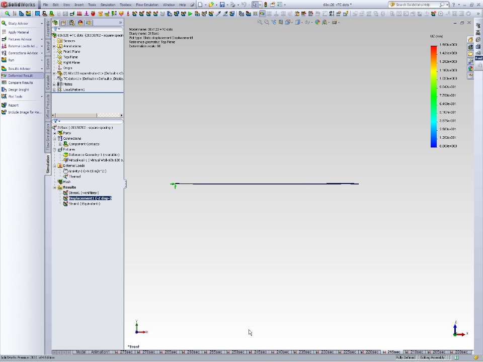

2nd (and more important) - when I duplicated a simulation it added a 2nd triad and coordinate system.  The 1st image below is from my original simulation setup.  Then I duplicated it and changed the time step of the Flow simulation that it referenced.

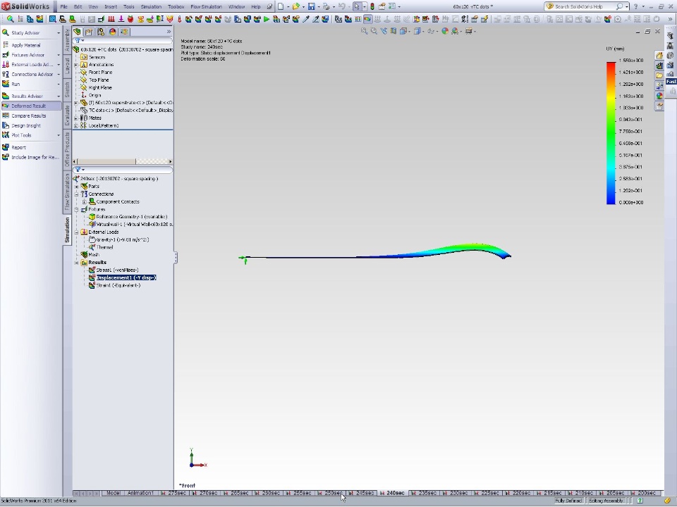

If you look at the bottom image, there is an additional triad in the lower right corner.  But it is not in agreement with the original in the lower left.  So I have to change my plots in some instances to representing Z-Disp instead of Y-Disp.  But it is not in 100% of the duplicate simulations, some of them are truly identical to the original.
Is this  just another "feature" of Solidworks Simulation or what happened?  And more importantly, how do I eliminate it?
(okay, I figured out the "how to eliminate it" part - it apparently added a local coordinate system to those plots.  But the question still remains, why did it add it in the first place?)
