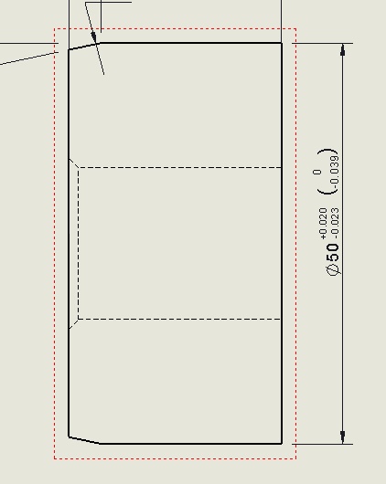

Is there a way to put two different tolerances on the same dimension?  Not tolerances of different units, but two different tolerances with the same units.  We have instances where we need to put the tolerance on the part after finishing (anodize, paint, etc.) as the final tolerance, but then in brackets the tolerance after machining only.  We have been putting these on as a drawing note, but I'd like them to be in the model sketch so they can travel to any print the model is imported to.  I know they can be added as dimension text in the sketch dimension dialog box too, but they do not act like dimensions - only dumb text.  I'd at least like to be able to stack them to make them look like a tolerance.
