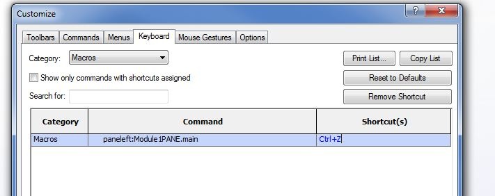

I run dual screens when I work and I'm not exactly satisfied with the way SW deals with files when you open them on a dual screen system, i.e. my parts open centered on the split.   Typically, I "restore down", resize the window to fit nicely on one screen and drag it there.   Easy enough, but this gets old 30x a day.   So I made a key stroke macro, edited out the 100 lines of extra code and came up with this:

The macro works like a charm if I run it from tools or drag it to my toolbar, so I tried assigning ctrl+z to it through the customizing procedure...create folder in sw data named macros etc.    The command shows up fine in customize keyboard, but will not run when any keystroke is assigned to it.
Any insights?
