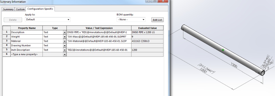

I have SW question, I want to create 2 separate BOM's one for the US and one for the rest of the world.
So the first BOM is to be Metric. The metric BOM is easy as my Primary Dimensions are Metric, but because I drive the BOM description etc (as you do) with model property "Value/Text Expression" in the second BOM I want to use only the dual (Imperial) dimension. I am asking too much or is this possible. The second image below is from Auto Cad, this is similar the result I am looking for.
