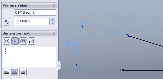

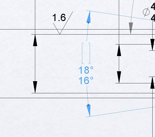

Dual dimension angle with limit tolerance.
I know there is a SPR for this, but does anyone have a work around?  I get so annoyed when functionality that worked in 2010 doesn't work in 2011.
Here is what's going on....If you put a limit tolerance on a angle dimension with dual dimensions, it puts the brackets above the angle with no value.
