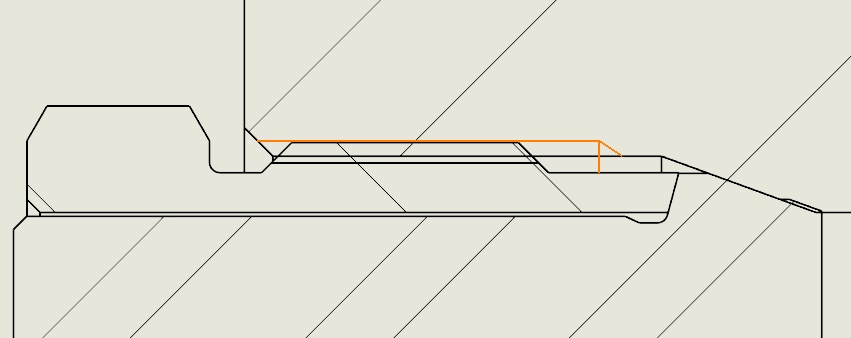

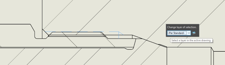

One of the things noticed after running that macro is that the cosmetic threads are set to the "Tables" layer, hence making them a solid line type.
Does any one have any idea of a code snippet that is needed to:
  1. run through all sheets in active drawing
  2. find all cosmetic threads
  3. Set layer to "Per standard"
Not sure if this is possible as I don't know if the cosmetic thread is "seen" as separate to everything else i.e. not considered an "swNote" for example
