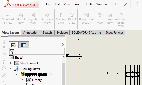

This is what the toolbars/tree look like:
I can right-click on views in the tree and select Properties, make changes in Hide/Show components (and the views update), etc. but it just doesn't ever exit the properties window correctly so I can't save or exit correctly.
I can move views, dimensions and notes around, but can't edit annotations. I can open, close, save other files, but SW won't close when I hit the exit button. I've gotten it to "snap out of it" a few times but I don't know how. Any help would be much appreciated as I've lost a good bit of work several times now. I have gotten into a habit of saving every time I add/edit a view but the current assembly has over 1,500 parts so every view change takes time to reload.

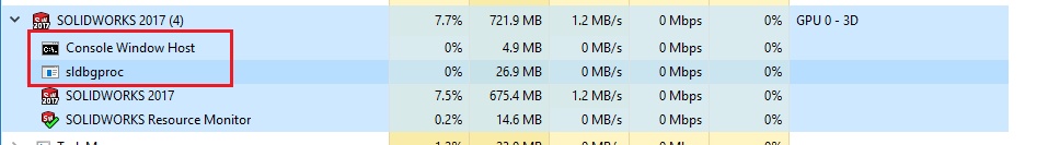

I've closed all other applications and made sure no dialog boxes are opened as well. I just noticed another weird thing that I haven't seen before. In Task Manager there are two processes under the SW 2017 process group (Console Window Host and sldbgproc) that keep starting and stopping, don't think it does this during normal operation, might be hanging in a loop somehow?
Also I am able to get the behavior to occur by hiding a component, clicking Apply and Okay, then going back into Properties and removing it from Show/Hide list and clicking Okay. This time around the above processes were not starting and stopping so that may be unrelated.
