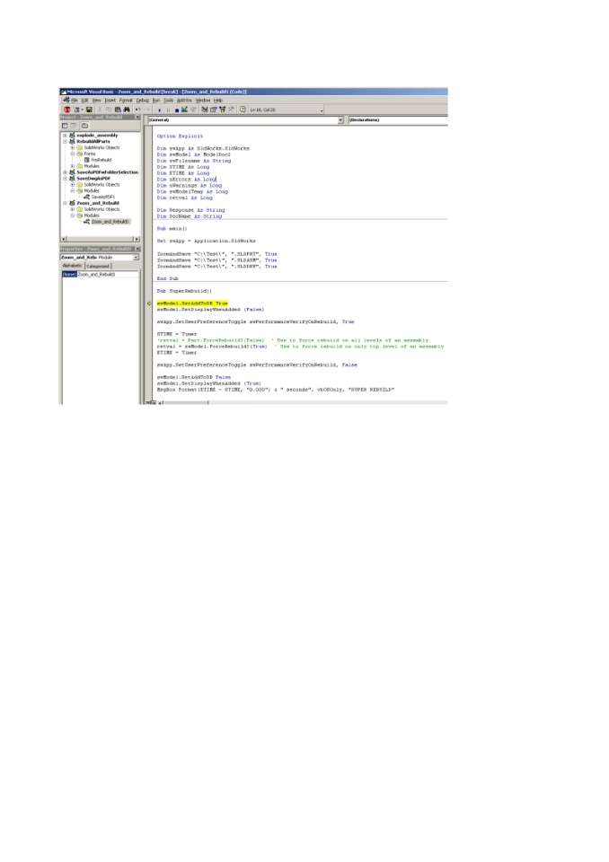

Drawing-update & save
I have not solved problem with this macro.
After I have approved an assembly, I want that all drawings of partners and sub-assembly is automatically updated and saved again.
It will take forever to update all drawings one by one when you have a collection of 500 shares in. Are there other options to update the drawings faster. I think a macro will help.
When you print the drawings through EPDM viewer has not been updated to output a few old drawings.
I have SW 2010th.
Macro Zoom and Rebuild does´t work. I have not experience with macro structure. Is there anyone who can do it?
Who can fix this macro?
Help!!!!
Option Explicit
Dim swApp As SldWorks.SldWorks
Dim swModel As ModelDoc2
Dim swFilename As String
Dim STIME As Long
Dim ETIME As Long
Dim nErrors As Long
Dim nWarnings As Long
Dim swModelTemp As Long
Dim retval As Long
Dim Response As String
Dim DocName As String
Sub main()
ZoomAndSave "C:\\Test\\", ".SLDPRT", True
ZoomAndSave "C:\\Test\\", ".SLDASM", True
ZoomAndSave "C:\\Test\\", ".SLDDRW", True
End Sub
Sub SuperRebuild()
swModel.SetAddToDB True
swModel.SetDisplayWhenAdded (False)
swApp.SetUserPreferenceToggle swPerformanceVerifyOnRebuild, True
STIME = Timer
'retval = Part.ForceRebuild3(False)  ' Use to force rebuild on all levels of an assembly
retval = swModel.ForceRebuild3(True)  ' Use to force rebuild on only top level of an assembly
ETIME = Timer
swApp.SetUserPreferenceToggle swPerformanceVerifyOnRebuild, False
swModel.SetAddToDB False
swModel.SetDisplayWhenAdded (True)
MsgBox Format(ETIME - STIME, "0.000") & " seconds", vbOKOnly, "SUPER REBUILD"
End Sub
