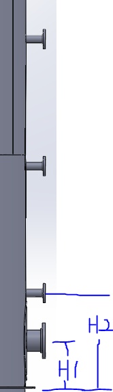

I am trying to get a table in my drawing that will auto populate the elevation and orientation of features in my model. (see attached image 1 and 2).  In image 2 the numeric value is controlled by my set of global variables.  Right now i have to manually enter in all the elevation and orientation values for the 30+ features into a general table.  Is there a way that i can link the value of a cell to the value of a global variable similar to how you can link a cell to a property such as description?
