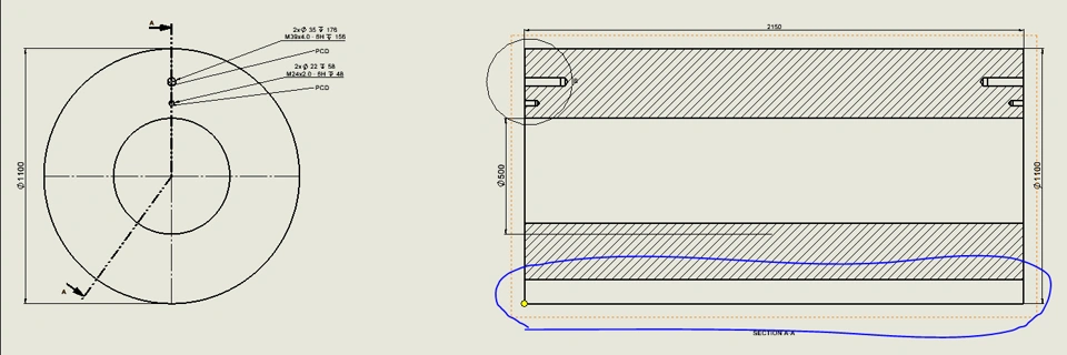

Hello all,
So, I am creating a section view from front view using VBA macro. Its creating the section view alright as required, but the problem is, the 2nd segment of the section, is not displaying correctly, as if the second segment of the section line is not intersecting the model edge fully.
When I manually edit the sketch of the section line and move it just a little bit and then exit sketch by pressing ok the section view creates just fine.
So I am guessing it might be the graphics issue, or something else.
Here is my code for creating the sectioned view, and the resulting image as to what it creates.

See the encircle bit in the sectioned view. That's the problem and I cant figure out a way to eliminate that using API.
Any help would be very much appreciated.
