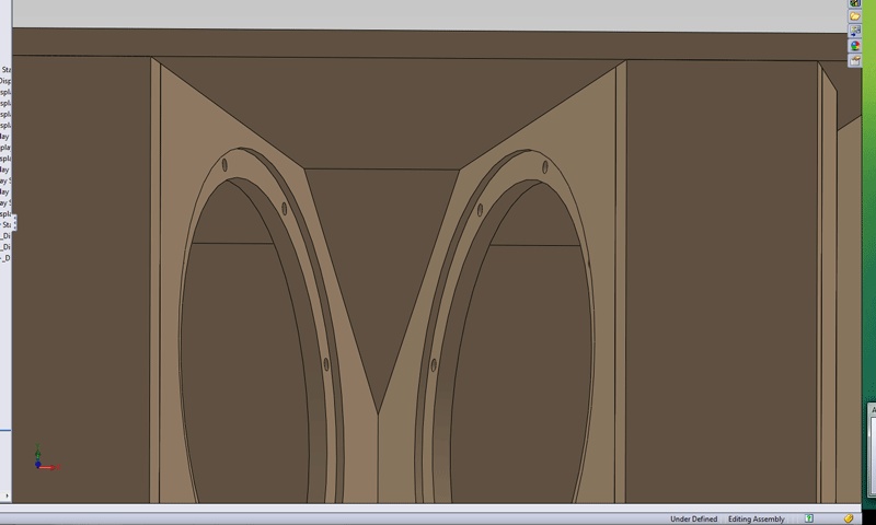

I have a corner made up of three flat sections. Horizontally the angle between the panels is 40 degrees and the angle to the lid piece from these is 90 degrees........

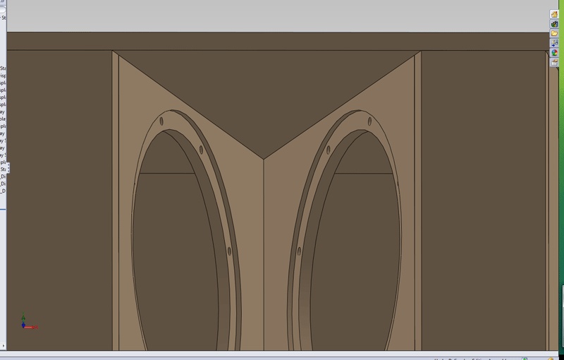

and i would like to close off the corner with an angled piece to reduce the corner volume like this......
The other panels dont need cut away or anything to join with it, this piece just needs inserted into place to close of the corner.   Now i have drawn and created the piece as you can see within the assembly, and have saved it as a part and inserted it into a drawing but have the same problem as before that because it doesn't lie on any plane (I had to draw across all three planes to get it into place) when i insert it into a drawing it is off angle, and i can't just use the move copy command because i've drawn it fairly arbiterily into the corner and don't have exact angles or sizes i can type in to move it.
I assume there must be a more sensible way of doing this than what I am currently doing that would solve this problem, and wonder if people can point me towards it. As i see it my choices are to either A) have some way to set a new set of axis specifically for that part within the assembly, even though its out of line with the axis of the over all assembly, so that when i start to draw it it's already on axis or B) have a better way of somehow moving the axis or rotating the part after its been drawn and saved out of the assembly into its own part file.
