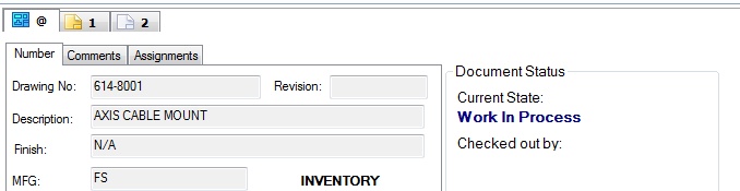

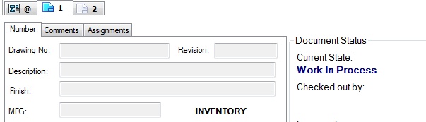

Drawing Data Card with configurations
Curious how to get information from my other sheets of the drawing to show on the drawing data cards. Everything shows up on the @ tab, Data is being pushed from model into the cards, 9In all reality I could careless for the @ tab.
From Drawing Data Card

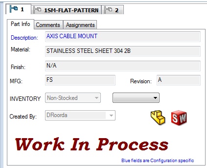

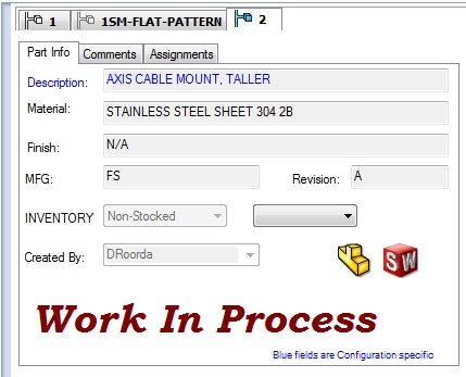

This is my Model Data card with info from the configurations within the model. Notice the description in this case is different from -1 and -2 config.
Sometimes are material, finish and inventory maybe different from -1 and -2 configs and Id like my drawing data card to reflect that as well, i think this is different than using the \\\$PRPSHEET in the Variables as these are configuration specific,
