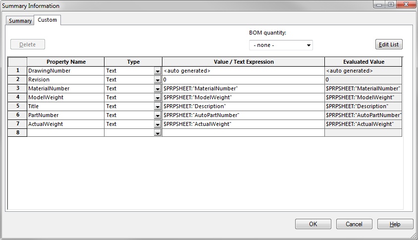

Mine look like this:
This makes it so the title block is automatically filled in, and lets us change the TB without editing the sheet format.  If there is a better way I'm all ears!
But these values are useless for being read into our PDM.  I feel like something needs to get read into PDM, ie at least a part number and description for the drawing.  I don't knoe how to get those from the part/model to the Drawing custom properties...
