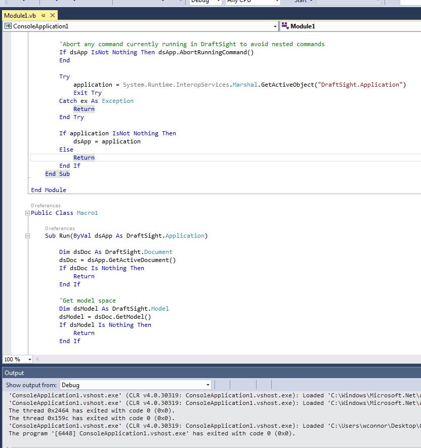

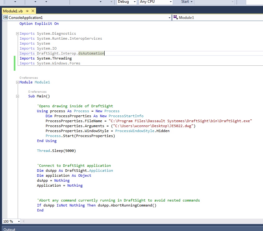

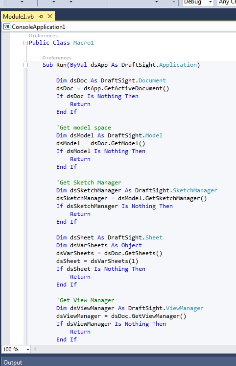

Hello,
I am having trouble with a macro I recorded in DraftSight, I am using Visual Studio Professional 2015 and the macro is
written in VB. When I run the code it will open the correct drawing in DraftSight. The next step is opening up the Layer Manager
and "turn on" a single layer, but this code never executes and the program still exits with code 0. Any advice?
*I have attached a few images of the code (See Below)*
- I have also tried running it in Visual Studio 2008 and still having the same issue.
Thank you!
