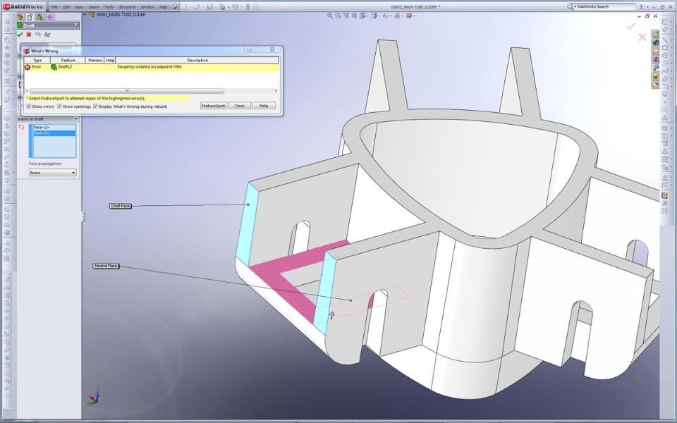

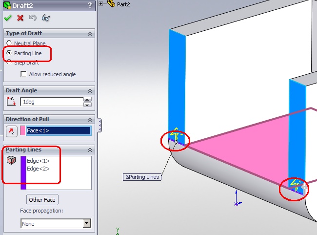

I am in need of some guidance putting draft on my model.  When I attempt to draft a face adjacent to a fillet the feature (the draft) fails stating: "Tangency violated on adjacent fillet" (see attached illustrations...yellow face is what I'm having trouble drafting).  How can I get around this?  Do I just need to make a manual cut on the face to create my draft?
Thanks!
Aaron
