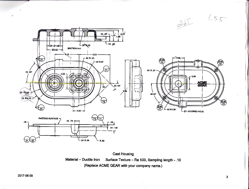

Drafted hole diameter off by .01 and I don't see why?
I'm going to a competition at the end of the month and this is a drawing from last year's test that I have to practice. The bottom edge of the cored hole just before the fillet is supposed to be 1.8 but the best I seem to be able to get is 1.79.
