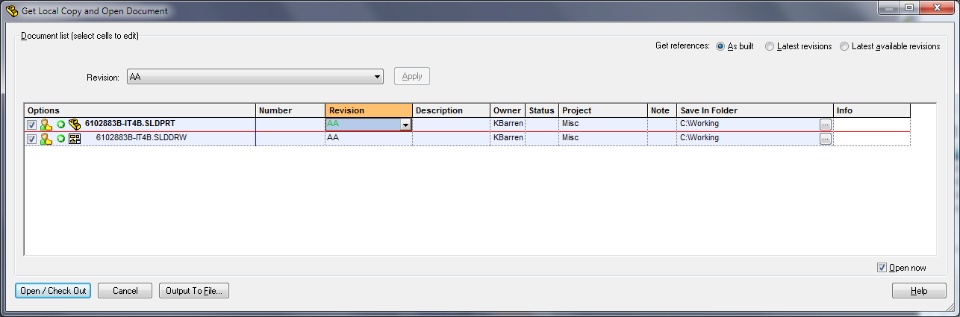

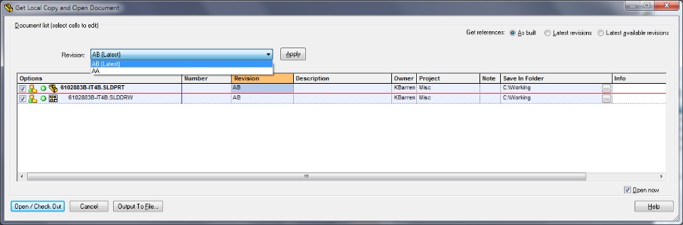

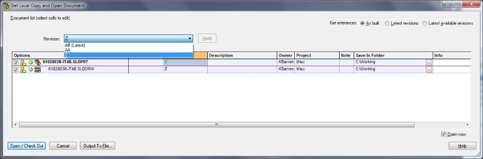

2. After the Revisions have moved to the double characters the files are no longer able to be checked out of the vault. When selecting open/check out, The error reads...
"Error retrieving "File Name.SLDPRT" from the server. Do you wish to continue anyway?"
When selecting "Yes" the check out fails and the error reads "Error opening "File Name.SLDPRT" in SolidWorks".
I have already verified that we are on the latest version of Adobe. Sequential revisioning is selected in the Vault Admin. Life Cycles are enabled. The Revision scheme is a range. Changing to a Primary and Secondary revision scheme doesn't solve the issue either.
