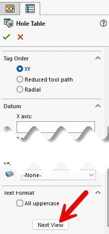

For those of us that create or have created Hole Tables on drawings in SOLIDWORKS Design, I'm curious to hear from those individuals who have used the "Next View" option in order to add holes from more than one drawing view for a combined Hole Table.  I'm also interested to hear from everyone else that has never used this option.  ("Next View" option at the bottom of the PropertyManager when creating a Hole Table, but not during edit operations later on.)
