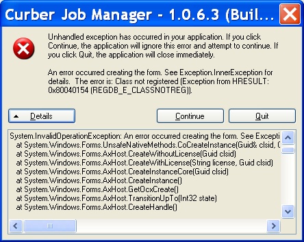

I simply have a eModelViewControl (eDrawing viewer) on one of my forms...everything works fine in 32 bit...but I have never managed to get it to work on a 64bit machine.
I've tried using both EModelView 2010 and 2011, but on 64bit I always get..."Class Not Registered".
I tried registering, with regasm.exe (from both Framework/Framework64 folders...don't know if there's a difference)...using the /codebase switch and /tlb...
I don't know what to try anymore...can someone shed some light please?
I even tried Luke's eDrawings Control (http://www.angelsix.com/cms/downloads/free-products/65-angelsix-edrawings-control), but I get the same problem...
I'm using VBexpress 2008 and .Net 3.5.
Here's the error I get on the 64bit machine...
