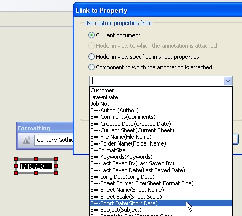

I am thinking about doing the above..

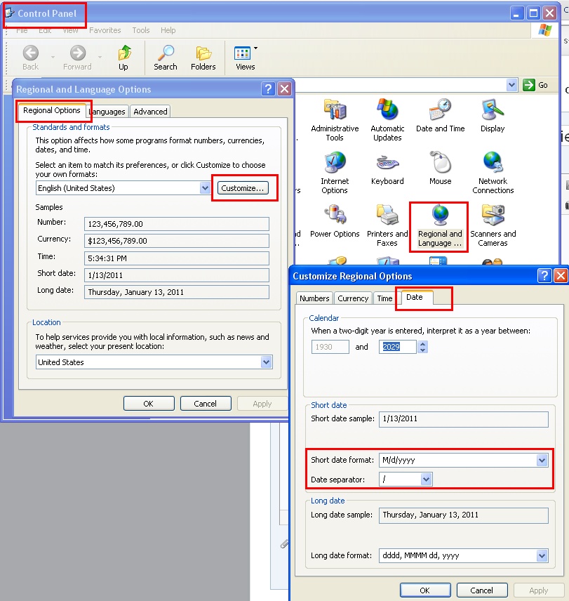

Including the created date, which is a PITA as you can only have the long date including the time. (Or is there a way of showing a short version of the created date?)
Main reason for post....
Can you show the last modified date instead of the last saved date?
The reason I ask is that users go into the file, print, then save when closing the file.
I am thinking that it should be common practise not to save the file when you havent modified it. But it's really easy to click "yes" when asked if you want to save the file upon closing.
So does anyone automate this, or do you type it in by hand?
Thanks in advance.
Trev
