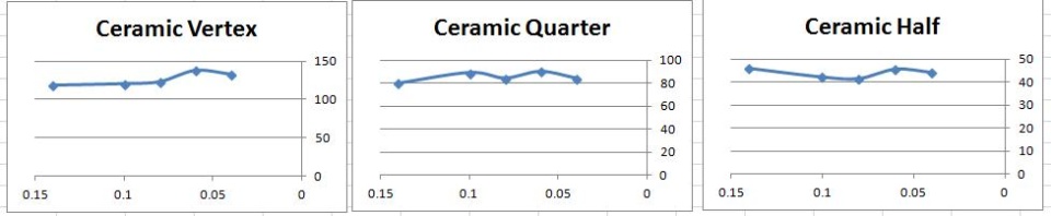

Do convergence tests work when using curvature-based meshing?
I'm trying to graph a convergence plot on a few high stress spots of my model but even with a large mesh size, it appears to be converged. There isn't much difference between a large and very fine mesh size. I'm thinking this is because I have curvature based meshing checked and therefore there are more nodes in that area. Does that seem right?
Is there a different way convergence tests are conducted when curvature based meshing is used?
Thanks,
Jeremy
