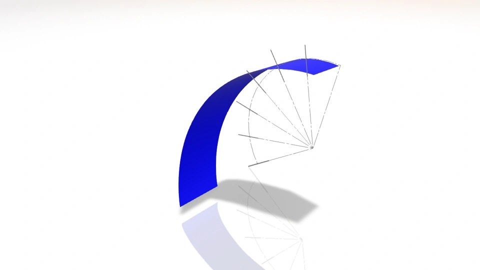

I’m trying to create the sheet metal enclosure for an elliptical staircase; I modeled the stair flights and landings using single, continuous sheets. Now, my biggest issue is that I need to split these sheets... I’ve tried various methods to do this—using the cut tool (with the thin feature) or the split feature. Visually, the split looks perfect, but I need to flatten the parts... The problem is that I need to divide them into multiple sections; if I split a sheet into two parts, it flattens perfectly, but if I split it into three or more parts, it won't flatten anymore...

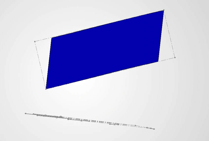

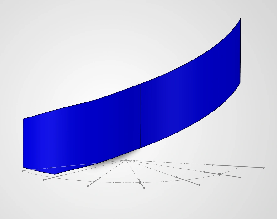

As seen in the figures above, I can easily flatten both parts...

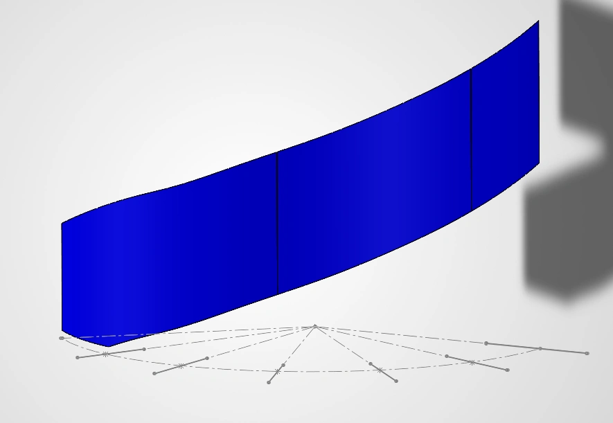

But if I try to divide it into 3 or more parts, it no longer unfolds...

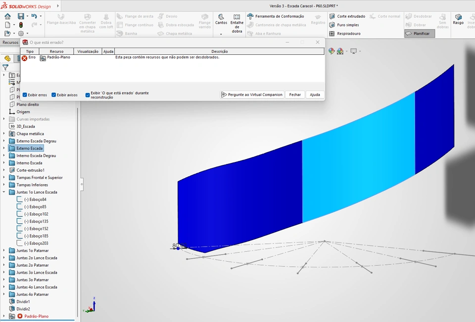

I can flatten the end pieces, but not the center one; this error appears...:
If I divide it into more parts, only the end pieces flatten out; the middle ones don't.
