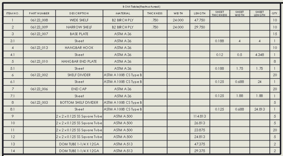

Tubes are correct:

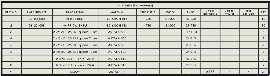

Sheet metal is not correct
Any idea as to why this is happening? Is it something on my end that I'm not seeing?
