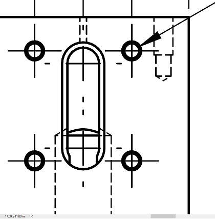

In a model, I generally like to display tapped holes as "thread removed" so I can clearly see the thread depth and tap drill depth without having to open the feature.
However, this looks ugly in a drawing view - especially for smaller holes. You end up with two concentric circles that are barely offset from each other and it looks like the lineweight is just off for some of your holes.
Is there a way to display holes in the model as "thread removed" but have them display as "tap drill diameter only" or "cosmetic thread" in a drawing?
