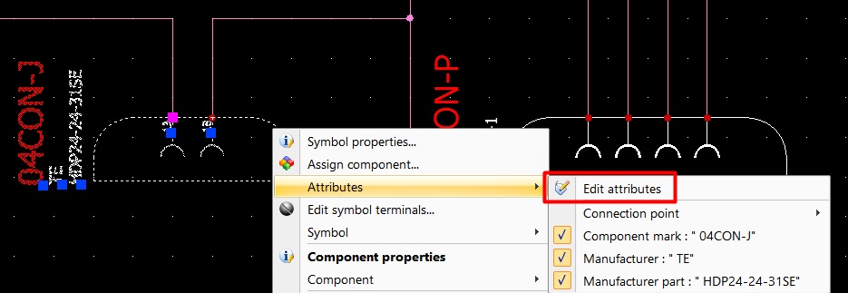

I am trying to create a new connector configuration and I can't figure out how to get the connection points to display.
On a previous connector configuration I had used they display no problem but that connector is too large and I'm trying to reduce its footprint on the drawing.
Here is the configuration I created, then manually added the connection points (fig. 1) using the right-click menu (fig. 2).
Figure 1
Figure 2

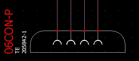

If I insert another connector (fig. 3) using that same configuration, the connection points don't show up.
