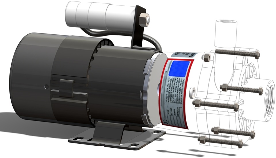

I'm not sure how this happened, but I have an assembly in which some of the parts are stuck in the Hidden Lines Removed display style. Any new parts in the assembly or parts that were suppressed show up in whatever style is selected, but a few parts just won't update.
The appearances have been removed/changed. The parts open up correctly outside of the assembly. Tangent edges removed/visible doesn't change anything. Real view or normal doesn't either. Renders come out as normal. I restarted SW and the computer.My graphics card is an AMD FirePro V5900.
I have attached a picture of the problem.
Has this happened to anyone else before ? Any ideas on fixing it ?
