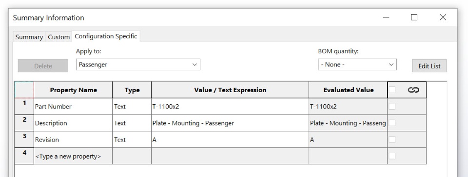

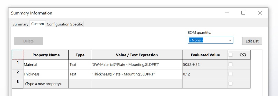

I have a part with two configurations. I would like to set configuration-specific properties (ex. Part Number, Description, Revision) and display those on the drawing. I have searched and researched online quite a bit and there doesn't seem like a way to do this, but I haven't seen it asked specifically, so I'm hoping you guys can help me to either make this work or share a different process to accomplish the needed outcome.
Part Properties

*Notice the lack of Configuration-Specific Properties
Maybe I am looking at this the wrong way. Is there a better process for getting the configuration-specific information displayed on a drawing? Surely there are thousands of people doing this.
