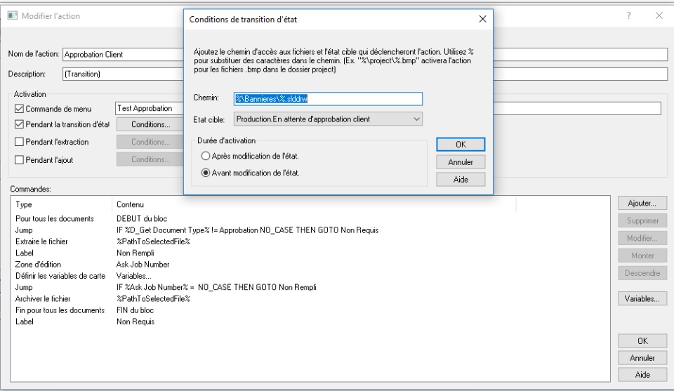

I'm currently working on a simple dispatch that need to ask an information from the user when a .SLDDRW is about to change state to "En attente d'approbation client" (Waiting for customer aproval). The Edit box will promp only if a Card Variables = "Approbation"
The folders of the slddrw I'm testing look like this:
In the top folder I have my main assembly with a Drawing of this assembly.
Then, in a sub folder I have multiple Drawings of sub assemblys
The problem is that when I change the state of the main drawing, dispatch only trigger on 1 of those drawing and not the rest.
Would any of you have an idea why? Sorry my PDM is in french I've put a traduction under the image:
Pour tout les documents = For all documents
Jump.... = Jump
Extraire le fichier = Check Out File
Label... = Label
Zone d'édition = Edit Box
Définir les variables de carte = Set Card Variable
Archiver le Fichier = Check In File
Fin pour tout les Documents = End for all documents
