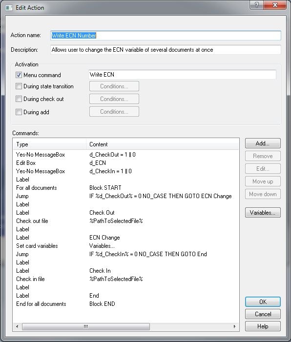

So I have been working on EPDM for a couple months now and have been using Dispatch to help with a few little things.  I am working on a way to simply change the contents of a variable then check the file back into the vault.
So far I have this:
Which allows me to check out the files selected, change the variable, but will not check the file back in. I keep getting an error that says: "Error checking in file; The file could not be found."  Everything else seems to work fine if i choose not to check the file back in.
Also I am able to right-click and check the file in manually just fine.  It just doesn't work through Dispatch.
