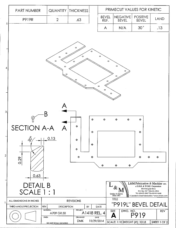

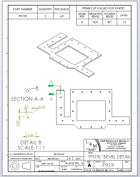

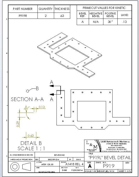

Having a strange thing happen to me this morning with section views disappearing off the drawing sheet.  I have some simple parts where I have two configurations (one for a left-hand bevel and one for a right-hand bevel).  I can make the sheets and print them out fine (see both sheets on Capture 1).  If I save them and then reopen them, I have what is shown in Captures 2 & 3.  The dimensions are still there (but are dangling) but there is no geometry for the section view although the arrows are still present (which is why dimensions are dangling).  Any ideas?  All looks fine until I save / reopen the drawing.  Not sure why this is happening.  Thanks for any input!
