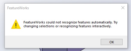

I have approximately thousand SW files that I want to regenerate with recognize features tool. I have managed to find a macro and majority of it runs as needed. Problems start when features recognition can't create features and prompts warning, because somebody needs to press "the button" before program can go to next part.
How to disable this warning box?
