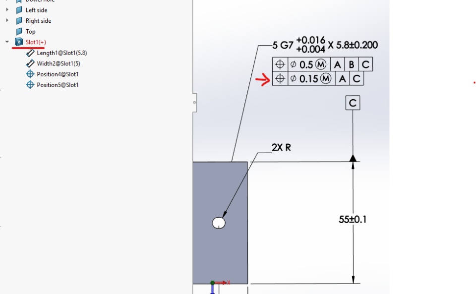

Dimxpert refinement overdefines feature
I have a slot hole that's positioned tighter in one direction than the other, but if I add a refinement position tolerance to the slot hole it becomes overdefined. It thought this is the way to go to indicate different tolerance zone for each direction. It's fine when only the 0.5 tolerance is in place.
Am I doing this right and is this a bug or am I setting up the tolerance wrong and should I solve this differently?
