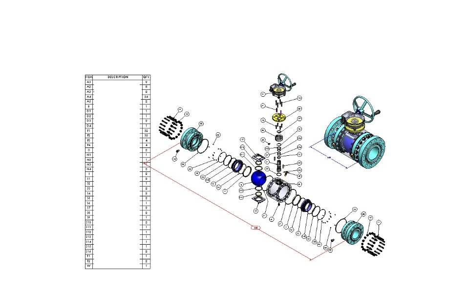

dimensions shown in different configuration on the views with another configuraiton
can we mark dimensions shown in different configuration on the views with another configuration.
as the example shown on the attached picture, the face-to-face dimension for the valve is needed to be shown in its exploded view(dimensioned in red), NOT necessary on the default assembled view (dimensioned in blue).
do you have any suggestion? does it need me to raise ER too?
