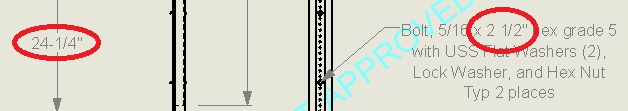

Hello,
I have custom properties in Parts that are linked to dimensions within the Part.  (See attached.  I create new configurations as needed, and when I do so the "Part Name" configuration specific property is automatically added, with the link.)  When I use this custom property in a Drawing note 2.5" will display as 2 1/2" instead of 2-1/2".  Is there any way to get that dash in there?  I've hunted everywhere I can think of.  It's not usually a big deal, but I've got a client that marked it up, and I'd rather not have to override my property (or try to explain the inconsistency).
