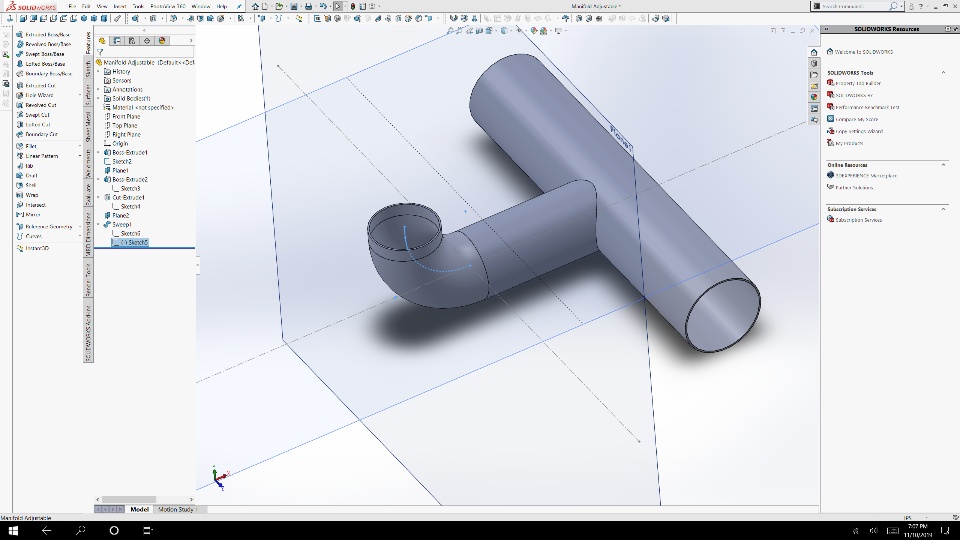

New to SolidWorks 2019 I am struggling with some simplistic concepts … first of all, why is cutting an extruded pipe profile a two-step process? First the outer-circle extruded boss, followed by second inner circle extruded cut? Then, on top of that, a "Swept Boss" requires an altogether separate sketch and feature process for a "Swept Boss" extrusion to mate with the first extrusion … seems cumbersome. I know the Pipe Routing tools are available in Premium, but I only have the Professional License.

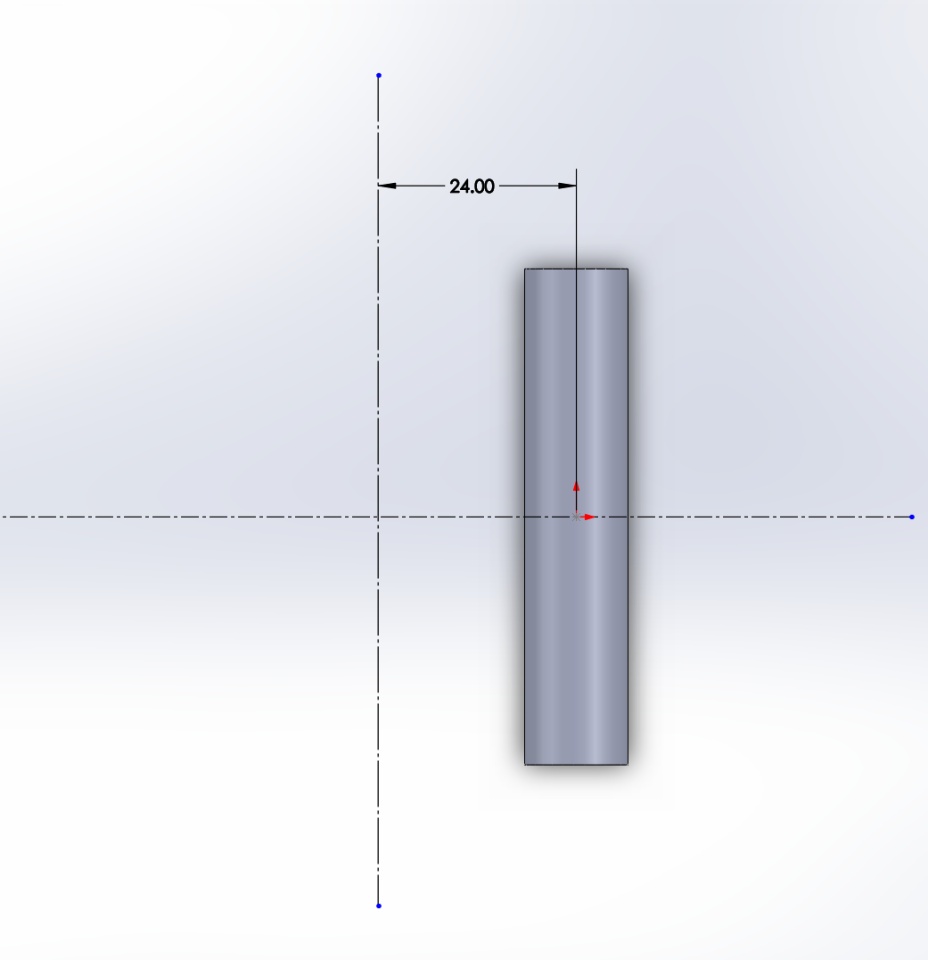

Anyway, to the images below … I would like the dimension seen below to drive the starting point for the 90-degree swept boss seen in the second image. So, if I needed the "Swept Elbow" to be 48-inches off the manifold center, all I have to do is edit the "Extruded Cut" sketch and modify the driving dimension from 24" to 48". But, this layout is not working that way - at least not with this approach.

Instead of Extrude-cutting anything, try using a Shell command after your Extrudes and Sweeps.
Without the part file I'm only guessing, is your elbow made to start from the Plane1?

To align the sweep with the end face without an extra feature:
  1. Expand the "Options" drop down in the Sweep feature manager
  2. Tick the box for "Align with End Faces"
You can also tick the box for "Merge Tangent Faces" to clean up the circle where the elbow portion meets the straight portion.

Thank you everyone for joining in this discussion … I am inserting 4 new images (sorry for the large screenshots) which depict a successful approach to my original query … "wanting to use a dimension driven element (in this case the initial straight extruded boss) to drive the entire swept boss and pipe length together as a unit back to the tee connection at the manifold." In the images here, I accomplished this by using a dimension driven construction line. After producing the straight and swept boss elements, I can now edit the construction line dimension which will drive the elbow and straight pipe length as a whole.

You could extend the Sweep Line into the bigger pipe center and then trim the excess with a Cut Extrude..

LOVE THIS! Thank y'all so much! So, I have redrawn the sketch for the swept boss, but I don't see a way to direct the "cut to surface" function? I need to sweep/extrude the pipe profile into the pipe material on the manifold seen to the right.

Kinda surprised no one's touched on this:
It's not. I mean, it can be if you want, but it doesn't have to be. Just create 2 circles in the same sketch. Dimension however you like: Pipe OD + Pipe ID, Pipe OD + Thickness, whatever, then extrude. SolidWorks will extrude the profile between the circles.
You're probably better off though laying out the piping in a skeleton sketch, sweeping a solid circle along it, then shelling to the desired thickness. Keep in mind that with the shell tool you can select multiple faces to shell through. So if you were to shell a pipe, you'd select both ends, not just one, otherwise you'll cap it.

you could use the Thin-Extrude option in extrude so you don't have to cut out the inside of the pipe or just offset the outer diameter of the pipe in the sketch. also if your pipe is not just a straight then you would probably want to sweep the entire length of the pipe in one go; elbow and straight. so then it's two sketches plus a sweep for the whole thing.
