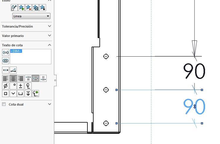

Hey, this is driving me crazy. I haven't done this before. What I want is to save this dim style, but i'm still struggling with it. It seems that some functions are not saved. Can you help me?

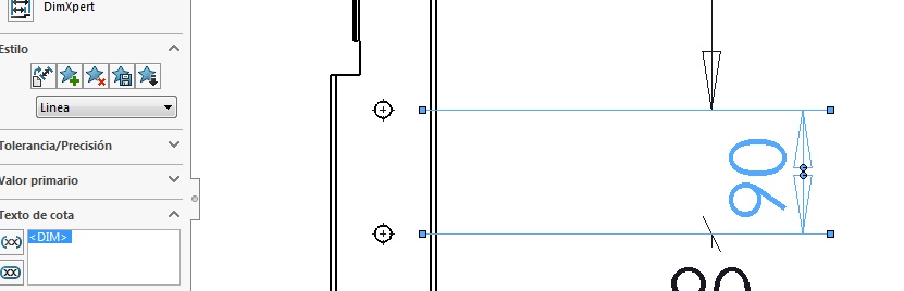

This time I saved the style. But when I try to apply the same style to other dim this is what happens. I'm telling you about arrow style and text position.
