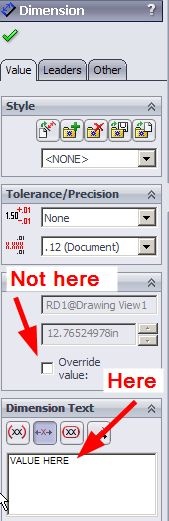

Detecting dimension value thats not
I know the design checker checks for Override Value but what about if someone types a value in the "Dimension Text" box, removing the and replacing it with their number for text.
I found the macro below that detects if the Override Value is changed but what about if the "Dimension Text" has been changed?
