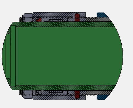

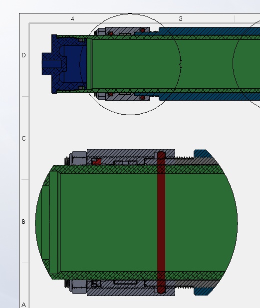

Detail View of Section Showing Wrong Bodies
The top image is the section view, and appears properly.  In the detail view below, you can see the threaded rods, which are behind the view, and an o-ring which isn't getting sectioned.
CTRL-B makes the o-ring better,  but not right.  CTRL-Q changes it back to tthe image above.
I'm reporting this to my VAR (we'll see how that goes) but I didn't know if anyone here had a workaround.
