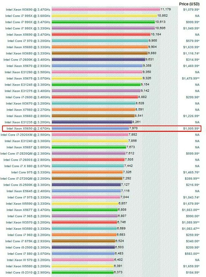

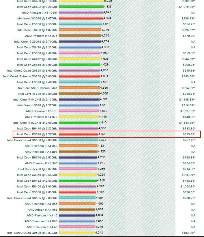

I finally put together my findings between the 2 machines. I was not the only one to test this machine out and compare it to the Dell machine. What all 3 of us found was that the Dell almost always out did the C20. When I reviewed the CPU per the link that Charles posted back in Dan's original thread the CPU in the Lenovo was about 3x the cost and speed was higher than the Dell. Another factor that was in the Lenovo's favor is it didn't have all the crap our IMS puts on our machines. Like Anti-Virus, Lotus notes... all the stuff we run everyday on our machines, which takes memory away from Solidworks.

C20:
T7500:
