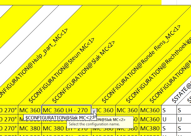

I have an ASM which consist of several parts. Each parts has configurations (defined in a designtable of their own). The idea is that the ASM's designtable selects the configs of the parts according to what config one wants to display.
In general this works. However today I needed to make a new variation of the ASM as well as it's parts and I ran into a strange problem.

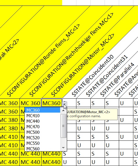

Normally when one enters the \\\$CONFIGURATION@PARTNAME one gets that it ends up populating the displaytable with easy to use pull down selections
However in one instance that just doesn't happen. All I get is :

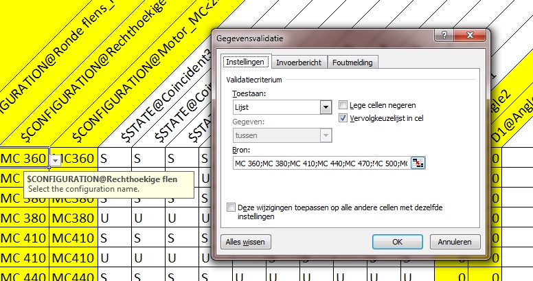

The only thing that I have discovered is that whilest in all other cases when looking at it on an Excel level I see

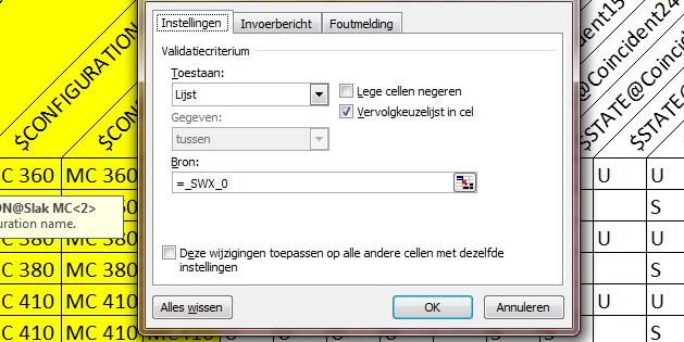

that it knows the selection that are available but for the one that doesn't work it only shows
Does anyone have an idea why it wants to use _SWX_0 as source for the list?
