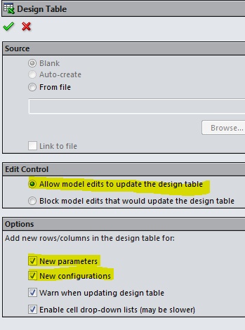

Design Tables Slow to Load
I was having issues were I wasn't able to add new configurations to my design tables so I edited the design table feature and selected this 3 settings.
Since I've done that it takes an extremely long time to load the design table compared to when there not selected 5-10 seconds vs. 4-6 minutes. Now I understand it takes time to process the information, so of my tables have upwards of 600 configurations.
However would it decrease my load time if I had all my design tables saved externally? That way when I go to make a change I can just open the excel file externally instead of having to open the file in Solidworks?
Thanks,
Peter
