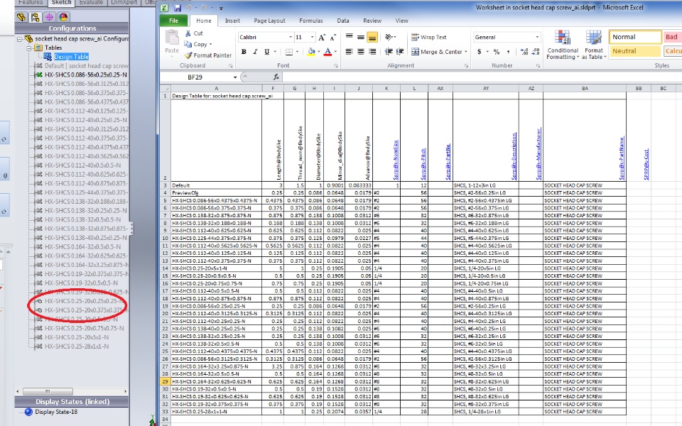

I have some toolbox components that I've created design tables for to add custom properties (part names & descriptions that comply with our naming conventions). However, when I insert a toolbox component with a configuration that isnt already in the part file, the design table wont update with this new configuration, it only shows the config with the yellow icon next to it in the configuration tree (rather than the other configs that are in the design table with the green MS Excel icon next to them)
How can I have solidworks update this design table automatically when new configurations are added?
The two configs circled in red are the configs that wont propogate to the Excel design table
