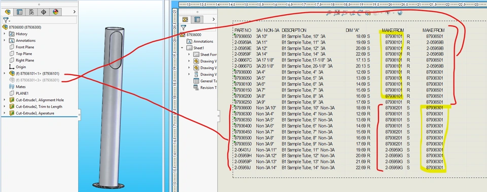

We have an assembly that's configurations are driven by two different "make from" models and I'd like to show the design table on the drawing instead of the dumb, manually filled table we are using now.
The yellow highlighted configs of the "make from" assemblies will confuse the shop and I'd like for these values to be hidden when suppressed.
I know that the table can and does show the suppression state but the shop won't know what that means.
