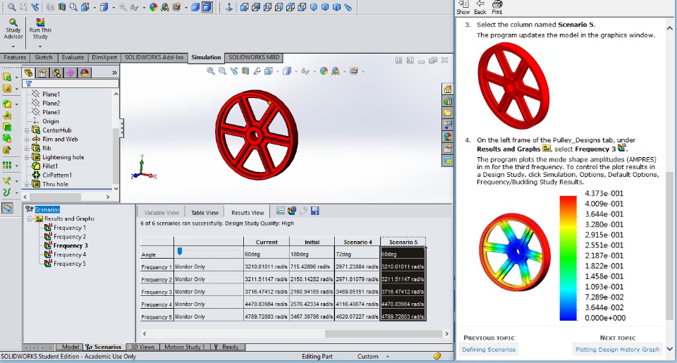

Hello,
I am currently learning the basics of Solidworks student 2015 and just going through the tutorials for design analysis when I encountered this problem.
For some reason, the plots for different design scenarios are not showing up at all as they should according to the tutorial. I have tried the other design tutorials and attempted to have them show the plots but none of them did. I am selecting the scenario then double clicking the plot I wish to see but no plot is shown however the model itself is updated to match the scenario. I am very confused as I have watched several youtube tutorials and all you need to do is just click the scenario then the plot to show.
Any help or advice would be appreciated.
Thank You.

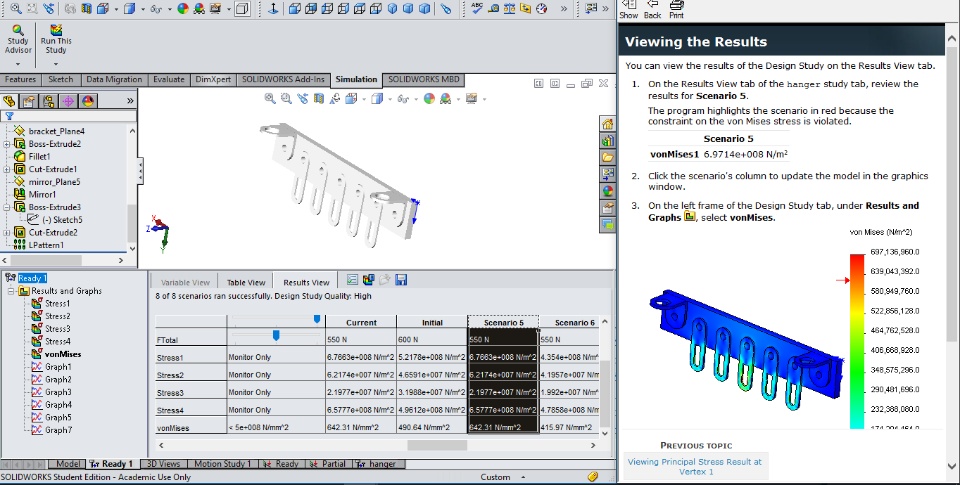

Edit: Added another screen shot of the error for a different tutorial
