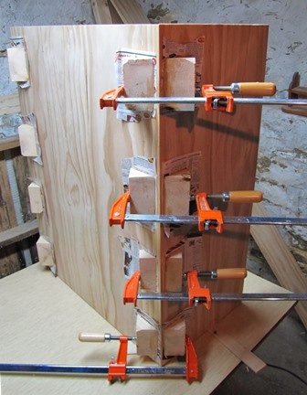

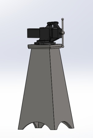

I'm working on a project, honing up on my solidworks skills.  I let you follow along from scratch. I'm wanting to build a large quantity of tapered pedestal machinery stands (Vise, Grinder, Swag-off Road Band Saw Table).  In all I need to make five or six of these. So I designed one up with a simple plywood design.  The simple plywood design looks good but rather difficult and very time consuming to glue up. (See photo of temporary blocks glued in place on paper.)

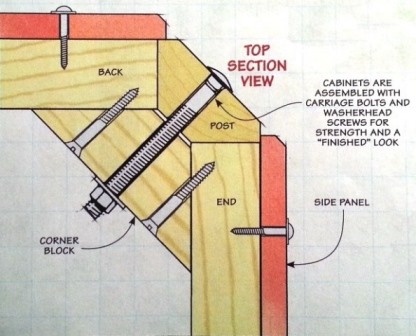

So I saw an alternative construction technique (Shopnotes Issue #97, pg 18 -- If you've never seen this magazine, there are some great projects in there.  I recommend them highly.)  This technique was used on a large cabinet / box structure with vertical sides.

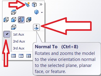

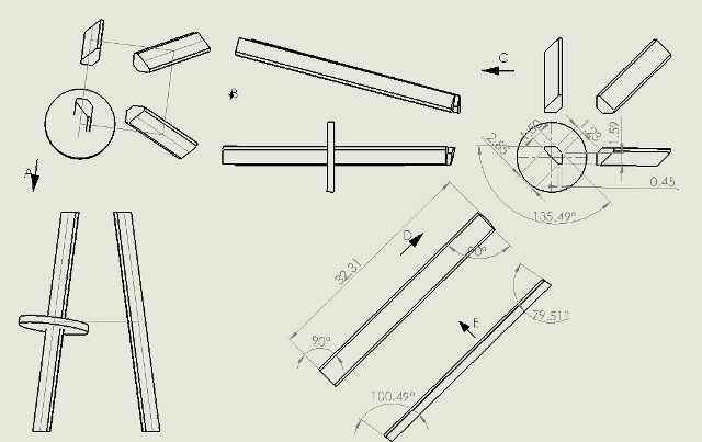

I want to use this technique on a tapered box.  I sketch it up using weldments and a few cuts with surface.  That went smooth. When I go to perform the complete drawing details, I have a major problem pulling off auxiliary views on the index 'leg'.  I spent hours trying to get an auxiliary view to take off.  I could not get view A to pull off correctly.  I finally added a phony element perpendicular to the leg's axis.  Then I was able to pull off auxiliary views so I could do the take off I needed. (And yes I know how to hide the phony element once the aux views are complete.   I left the phony element visible to remind me of how I did this, and to validate View C as TSS - True Size and Shape. )
So here are my questions:
--How do you guys create auxiliary views when the system seems to be fighting you?  Do you create phony elements too?  Is there a better technique?
--If not 2D style descriptive geometry take offs is the a better way to communicate the end view profile, overall lengths and angle cuts of those support elements? (Yes , I know I can do a 3d measure, and write that down on a piece of paper, is that really a best practice?)
--What happened to my butchered View Arrow for view B?  (I've tried every thing to fix that.. its just way too short to be visible.)
