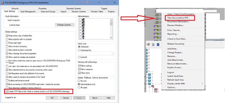

Now, with regards to the old WorkGroup PDM, since the feature was introduced, the below check box has been enabled in the Vault Admin settings.
Basically resulting in a PDF of checked-in drawings being auto-generated and available for quick-view from any logged in user. These PDF's are not directly accessible by the user and lie in the reference files in the vault data, server-side. All well and good; expected and intended behaviour. see below image for confirmation

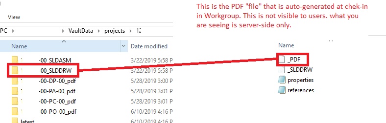

Below image shows how the PDF exists in the WorkGroup PDM server. Not visible/accessible to users. This is where the "View Document PDF" contextual menu in the above image, pulls the file from to display a PDF of the drawing to the user.

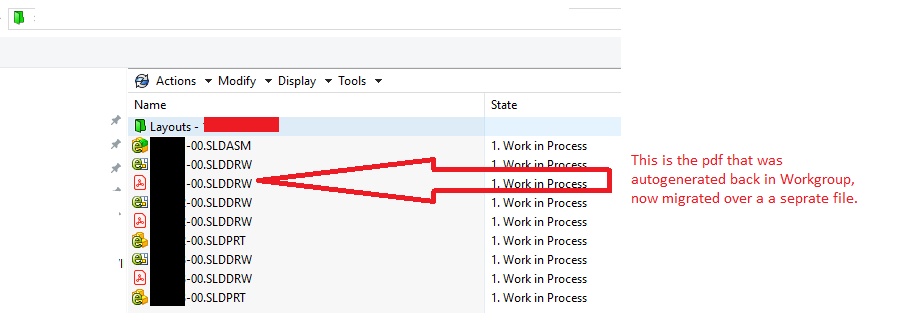

Test migration has  gone ahead smoothly, one of the issues we have noticed is that the migration tool brings along all the CAD data (that's fine) but also brings along all those auto-generated pdf's from WorkGroup as well and puts them in the vault in the same project folder as separate and independent, un-referenced files. See image below for example:
As you can imagine there are thousands of drawings and therefore there are equally thousands of PDF's like this, ported over as well. This will be a real trial to clean up and get rid of (assuming script won't do the job) and cause confusion to viewers when we go-live and until said clean up is down. (no time is allotted for pre-go-live clean up)
