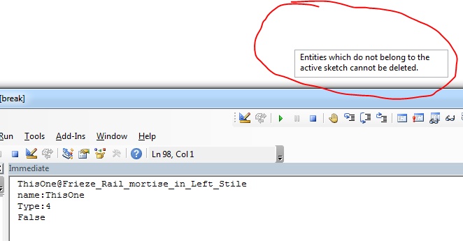

From what I can tell, I have the correct dimension. The call to select returns True but it doesn't get deleted.
I also get this box pop up with the messsge
"Entities that do not belong to the active sketch cannot be deleted."
When I add a break point after selection and manually select the dimension, it works just fine.
Somethings not right.. and I don't have a clue what else to try.

Debug.Print Haunch_swDD.GetNameForSelection
Set swAnn = Haunch_swDD.GetAnnotation()
If swAnn.Select3(False, Nothing) Then
Debug.Print "name:" & swAnn.GetName & vbCr & "Type:" & swAnn.GetType
Debug.Print swModel.Extension.DeleteSelection2(0)
